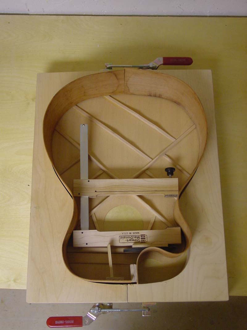

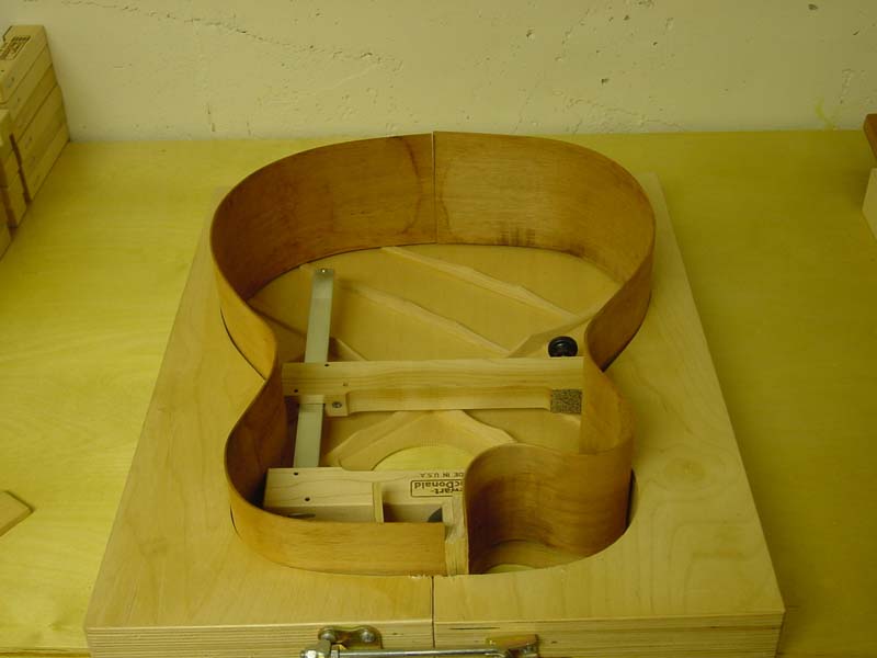

I know this isn’t a huge success, but, I’m just a little excited at what I accomplished this morning!
I successfully bent my first cutaway side! Both sides seem to fit quite nicely in the mold, however,
I did get a little scorching. I sanded with 120 grit right away, and it looks like I got almost all of it off.
I’m thinking its going to be OK after some more sanding. Perhaps though, I should ask if you
other hot pipe users have to deal a little scorching?
Here’s a couple of pics of the sides in the mold.
Thanks for looking!

Keep up the great work! I really like that top bracing. Nice and clean!

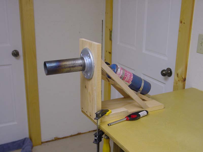

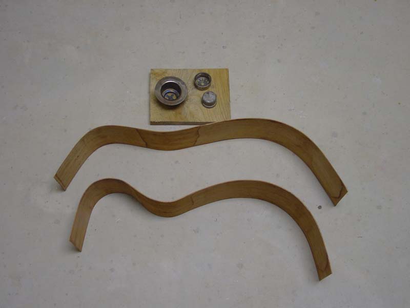

I should tell you that the side set I started with was pre-bent to fit a dreadnought. That had me a
little concerned at first, because I never heard of anyone re-bending sides before.
Anyway, (according to Cumpiano) I soaked the one side not for the cutaway for 10 minutes in a
bath tub of hot water. The side for the cutaway I did for 15 minutes. I was thinking, maybe a little
extra time in the tub would help to insure a clean bend. I started on the cutaway bend, right away.
Cumpiano, from what I remember, didn’t mention using paper or foil, so I didn’t. Truth be said, I
think I would have had less scorching if I would’ve moved a little faster.
The pics below show the set up, and a before/after side bend, to answer some of your questions.
Oh Yeah! Nope, didn’t burn my stomach, but, I was wondering about a smell,
I looked down to see a little brown spot on my T-shirt! So, I fixed that with an old sink drain,
and a pipe cap. Which made a very fine baffle to help even out the heat on the pipe!
